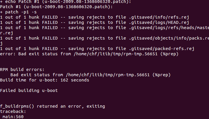

Hello, a problem about usage of ltib.
I generate a patch after I modified the source tree of u-boot. When I prepare to modify the u-boot again,error occured.

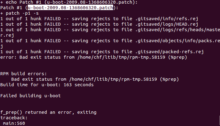

If I use ./ltib -m prep -p u-boot to unpack the source, error is like this, u-boot-2009.09-<10-digit suffix>.patch is my patch.
Some say maybe should use ./ltib -p u-boot,(ltib mail lists), I tried and error is like this.
I have tried to delete patch u-boot-2009.09-<10-digit suffix>.patch in u-boot.spec , yes ,it works,but what I have modified will be lost.
I appreciate if someone can help me to solve it.

jimmychan
the u-boot spec file is the <ltib>/config/platform/imx/u-boot.spec.in
you can try to add the patch in the spec file like this:
Source      :  %{name}-%{version}.tar.bz2
Patch0      :   abc.patch           <-------------- put your patch filename here. the patch file store in /opt/freescale/pkgs/
BuildRoot  :   %{_tmppath}/%{name}
%Prep
%setup
%patch0 -p1          <-------------  add this line to apply your patch when using 'prep' to extract the source.
