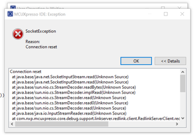

Hi everyone,

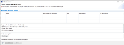

I am stuck with my imx1060 evk board, when i try too debug every sdk example the probe failed.
Error pop up appears with SocketException : connection reset
I try to reconnected/disconneted board, uninstall/install driver, uninstall/install MCUExpresso without any success.
I also try on another PC and I can debug on it, so it only hapen on my PC.
One more think strange, I have also an imxrt1050 evk and it works fine until today, since this morning imxrt1050 doesn't work exactly like the 1060.
Thanks by advance

I thinks I solved the problem,
Instead of uninstall/install driver in device manager, I uninstall device in printer device.
And for now it works.
