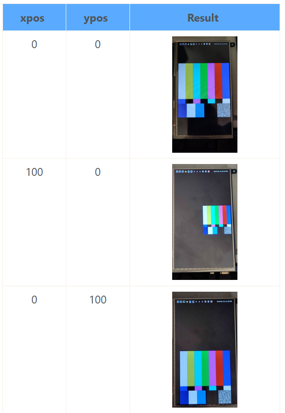

Dear all,
We are developing a display application using GStreamer and i.MX8MP.
Currently we are trying to understand how positioning parameters work using imxcompositor_g2d in combination with waylandsink.
Here is the pipeline example we've tried using GStreamer's CLI:
gst-launch-1.0 imxcompositor_g2d name=comp sink_0::width=100 sink_0::height=100 sink_0::xpos=50 sink_0::ypos=50 ! waylandsink window-height=1024 window-width=600 videotestsrc ! comp.sink_0
The command runs, but the behavior is not as one would expect.
Here I will post a picture of some examples with different combinations of xpos and ypos parameters, and their results:
Note: screen size is 1024x600
As you can see, the stream is ignoring the sink_0::width=100 sink_0::height=100 parameters, but more importantly the positioning doesn't seem to make sense.
Does anyone have any advice on why this might be happening or how to fix it?
Thank you.
Robert.

Hi Robert,
I think we can't control or set the window position manually, there's nothing wrong with the imxcompositor_g2d plugin. It might be an issue related to wayland. If my understanding is correct, when the waylandsink is fullscreen at the end you will have a scaled output.
If not using full screen and you just want to display a 100x100 video stream at position (x=50,y=50), it's impossible to do that using current gstreamer pipeline due to the wayland protocol limitation, and the window position will be random. See below:
gst-launch-1.0 imxcompositor_g2d name=comp sink_0::width=100 sink_0::height=100 sink_0::xpos=50 sink_0::ypos=50 ! waylandsink window-height=100 window-width=100 videotestsrc ! comp.sink_0
Some time ago there was a suggestion for this use case: If you want to overlay 100x100 at position (x=50,y=0) on the backgroud UI, you may try to use GstVideoOverlay to meet your requirement. This should be the official example.
https://gstreamer.freedesktop.org/documentation/video/gstvideooverlay.html?gi-language=c
Maybe you can take a look and evaluate this. That's all the information I could find at the moment.
