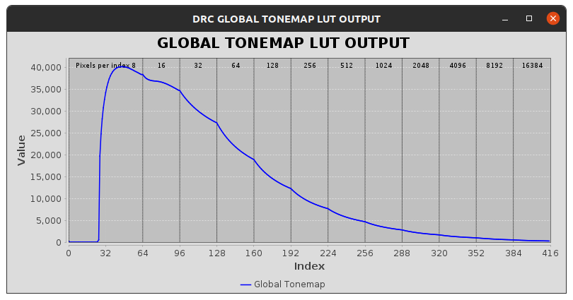

1> For GTM LUT, setup 416 values, profiled as below left, how to understand the input and output of GTM?

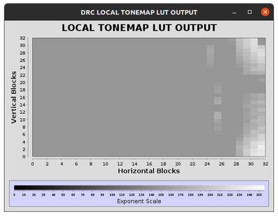

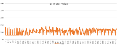

2> For LTM LUT, setup 1024 values, profiled as below right, we know it split the image into 32x32, how to map each block to high/mid/low brightness zone?
Any method to get the suitable gtm/ltm profile?

Firstly, the GTM and LTM DRC is used to enhance the performance of high dynamic range sensors like WDR. For linear sensors, GTM/LTM takes very limited effect.
As for the LUT, the LUT for GTM/LTM can change dynamically. To apply a fixed LUT, you need to change the UPDATE POLICY of GTM/LTM to ON_CONFIG then import your LUT. There is a way to visualize the LUT. In AGLBCE module, click generate and a window will show like below:
You can see the GTM/LTM LUT as below:
Global:
Local:
The tuning tool user guide will have more information about how to interpret those two charts.

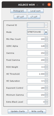

Basically, you need to follow these steps:
1) Start Camera, connect to the device via tuning tool.
2) Read dynamic parameters in “Live Control – Metadata”
3) Check the dynamic params for the scene (exposure, again, hdr_ratio, y_level,
lux_level)
4) Check the preview, capture raw/yuv images.
The AGLBCE WDR default tuning is split for example 2d interp of hdr_ratio and
lux_level to cover different scenes. For example hdr_ratio 1k, 2k, 5k, 10k, 40k,
>100k and lux <1k, >2k - for normal and high light. Interpolation is between them.
5) Find the region based on dynamic params and adjust tuning (via live tuning)
and check the preview/capture images (Raw image could be also PC simulated
instead live tuning).
6) Save the project when satisfied.
7) Test at different scenes and repeat. HDR studio scene with different illumination
level ratio between dark and bright side could be starting point.
The tuning is finished via AGLBCE block. But you need to tune GDRC by setting the alpha blending to 256 first and then tune LDRC by setting the alpha blending to 0.
The meaning of each parameter is captured in the user guide.
