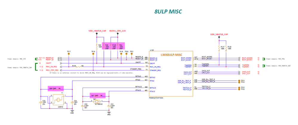

I now want to design a program to determine whether a pull-up resistor exists!
below pins: onoff, tamper0, tamper1, reset and so on

If my understanding is correct, you want to use program to operate misc gpios(output/input/set high/set low) to check whether a pull-up resistor exists. Is that correct?

tangchao90
yes!

Zhiming_Liu
The ONOFF, tamper0, tamper1, reset is not standard GPIO, these io has special function which could affect system running. We don't recommend you use these IO in your program.
