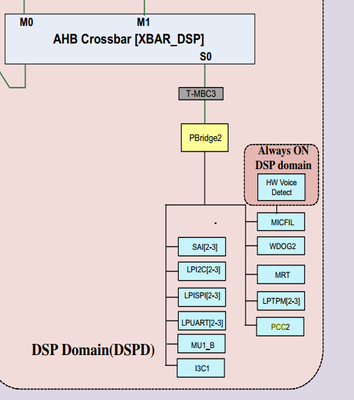

wendy-liu
hello! @Zhiming_Liu
       我刚刚又看了SDK中dsp_examples的sample code,他们的做法是在CM33上初始化DSP及硬件资源,启动DSP core;将实现的代码逻辑放在DSP core,通过MU进行通信。
      我想确认一下,如果想在CM33使用LPUART2,只能通过这种方式吗?还是可以在CM33通过TRDC直接访问外设?
8,439 Views
Zhiming_Liu
理论上是可以开放Pbridge2的特定内存区域给指定domain的,控制MBC3即可,开放PCC2和LPUART2的控制权给M33。对应的LPUART2中断号也在M33中定义了。
核心问题是时钟,由于这个LPUART2做在了DSP里,必须使能dsp_busclk,至少得加载dsp固件。具体的过程我还没试过。

wendy-liu
PCC2和LPUART2的MBC权限我也配置了,
/* non secure state can access lpuart2(PBridge2 slot 11, T-MBC3) for eDMA0 */
mbcBlockConfig.memoryAccessControlSelect = TRDC_MBC_ACCESS_CONTROL_POLICY_ALL_INDEX;
mbcBlockConfig.nseEnable = true; /* non secure state can access the block for eDMA0 */
mbcBlockConfig.mbcIdx = 3U; /* MBC3 */
mbcBlockConfig.domainIdx = TRDC_DMA0_DOMAIN_ID; /* MBC3_DOM0 */
mbcBlockConfig.slaveMemoryIdx = 0U; /* MBC3_DOM0_MEM0 */
mbcBlockConfig.memoryBlockIdx = 11U; /* MBC3_DOM0_MEM0_BLK_CFG_W11 */
TRDC_MbcSetMemoryBlockConfig(TRDC, &mbcBlockConfig);

Zhiming_Liu
你这个用的不对TRDC_DMA0_DOMAIN_ID,这两个外设应该给M33 domain:TRDC_M33_DOMAIN_ID

wendy-liu
我读了kCLOCK_FusionDspBusClk的频率,通过CLOCK_GetFreq(kCLOCK_FusionDspBusClk),它的频率为96000000。但是依然无法调用CLOCK_SetIpSrc()。麻烦您可以帮我再验证一下吗?谢谢!
8,522 Views
wendy-liu
Hello @Zhiming_Liu
I want to use lpuart polling example on SDK, the demo_example is LPUART1, but I want to use LPUART2.
How to config PCC_REG(kCLOCK_Lpuart2)?I read reg of LPUART1  and LPUART2 CLOCK, result is 0xd2000000 and 0.I guess the system has configured the LPUART clock with default settings.
8,515 Views
Zhiming_Liu
Please use other clock as source, then continue debug, you may need to configure trdc  for edma access like LPUART1 in  BOARD_SetTrdcGlobalConfig
