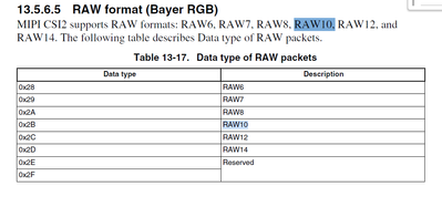

10,276 Views
Bhavesh_Bhadricha
hi weidong,
As per imx8m mini reference manual, RAW format ,pg. 4019 , CSI2 support RAW10.
kindly let us know the reason for mentioning CSI2 not supporting RAW10.
kindly correct if I mis understood your reply
