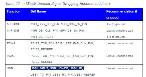

use only USB 2.0 signal pins, USB3.0 signals pins can be left unconnected.
