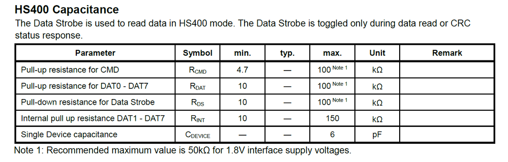

In my emmc datasheet says this:

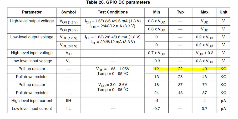

So I need 50K as maximun (I am using 1.8V) in all signals, I am thinking to use the internal pull ups of the imx8mp, that in the datasheet says that the maximun value is 49K.
I have a simple question, pull up configuration is associated to the GPIO function or is independent and can be used when USDHC3 peripheral is working with these pads?

nxf63675
Hi @diegoperez,
Well, depends on the way you configure your PAD but simply, the answer is yes, as these pins can be used as a GPIO.
