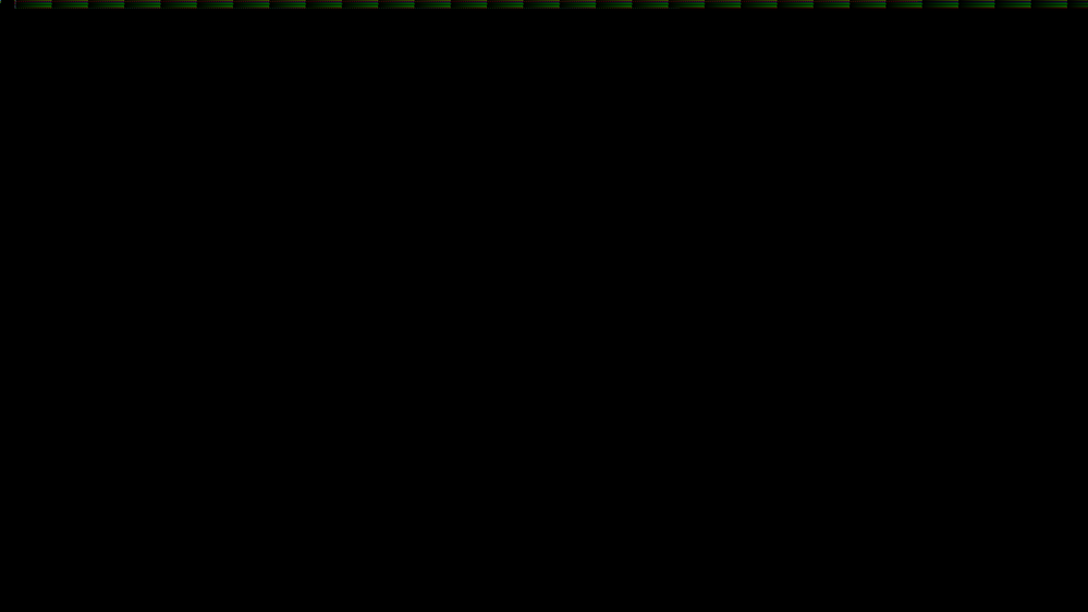

I am working on imx8mp PhyTec SoM module and connected a LVDS to MIPI bridge on CSI0 with a 2-lane configuration. The bridge is generating a test pattern and I am trying to understand on how to configure the clocks for this configuration.
I am able to capture the image from the camera, but it is not coming out to be right.
Below is the DTS configuration that I have been trying.
The commented lines, is everything I have tried so far.
The I2C of the bridge is working properly and I get debug output from it.
The bridge is using a pixel clock frequency of 74.25 MHz. It has been configured with 1920x1080 at 60Hz  signal.
Total Pixels Per Second=1920×1080×60=124,416,000
Data Rate=74.25×106×24 bits =1.782 Gbps (total). For two lanes it will be 891 Mbps.
And since DDR operates at twice rate, the clock frequency for MIPI will be 445.5 MHz.
Hence I tried configuring link-frequencies / clock-frequency to multiple of such values. However I don't get the right image.
In the kernel logs, I see the error:
[  472.546870] mxc-mipi-csi2.0: Frame End events: 3
[  472.551485] mxc-mipi-csi2.0: Frame Start events: 235
[  472.556446] mxc-mipi-csi2.0: Non-image data after odd frame events: 0
[  472.562882] mxc-mipi-csi2.0: Non-image data before odd frame events: 0
[  472.569406] mxc-mipi-csi2.0: Non-image data after even frame events: 0
[  472.575930] mxc-mipi-csi2.0: Non-image data before even frame events: 0
[  472.582540] mxc-mipi-csi2.0: Unknown Error events: 1277
[  472.587762] mxc-mipi-csi2.0: CRC Error events: 87
[  472.592464] mxc-mipi-csi2.0: ECC Error events: 43758
[  472.597425] mxc-mipi-csi2.0: FIFO Overflow Error events: 0
[  472.602907] mxc-mipi-csi2.0: Lost Frame End Error events: 231
[  472.608651] mxc-mipi-csi2.0: Lost Frame Start Error events: 3
[  472.614393] mxc-mipi-csi2.0: SOT Error events: 40031
My question is:
1. Am I missing anything in clock configuration?
2. Is there anything in ISI block, that I need to configuration?
3. Should there be anything else I should be concerned about? Any other parameters?

Captured image:
2,529 Views
AldoG
Unfortunately we do not have this kind of connection available on our EVK, so we may not have examples or references on how to do this.
Also, note that the LVDS does not have connection to the MIPI-CSI2, please refer to the Reference manual Figure 13-1. Display, Imaging, Camera I/F Diagram.
For this I would suggest to reach out either phytec or your module/camera vendor for the correct device tree bindings needed for your implementation.
Best regards/Saludos,
Aldo.
