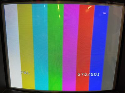

I would like to SD output 576i format data from LVDS interface using imx8mp SOM. So, i used to DS90CR286 for LVDS to TTL parallel converter and also used adv7341 for analog video converter.
Firstly, I modified my yocto image (5.15.71 kirkstone) for pixel clock=27MHz and resolution 720x576 using patch file. I generated test pattern using adv7341 board on 576i format clearly in this configuration.

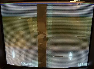

When i want to took LVDS output, i had double screen.
I think, i need to progressive to interlaced video conversion. So i added to “interlaced” flag to my “panel-timing” node (you can see in my patch file) and then i got “Failed to start Weston, a compositor, as a system service.” fail.
Is there any way to convert data format progressive to interlace for LVDS output using imx8mp SOM?
Do you have any suggestion for this issue? I added the patch file and log file in the attachments.

  • I have another issue about this problem. I got below message while booting image,
[  6.308408] imx-drm display-subsystem: bound imx-lcdifv3-crtc.0 (ops lcdifv3_crtc_ops)
[ OK ] Created slice Slice /system/systemd[  6.320968] imx-drm display-subsystem: bound 32c00000.bus:ldb@32ec005c (ops imx8mp_ldb_ops)
-backlight.
[  6.331538] [drm] Initialized imx-drm 1.0.0 20120507 for display-subsystem on minor 1
[  6.340020] imx-drm display-subsystem: [drm] Cannot find any crtc or sizes
  • Then i checked the drm utilities using this command

  • Above logs about image with interlaced flag and, CRTCs parameters not setted.
  • I share logs below about image without interlaced flag.

  • In these logs, CRTCs parameters setted.
  • Do you have any advise or solution about this problem? Why i get crtc or size error?
