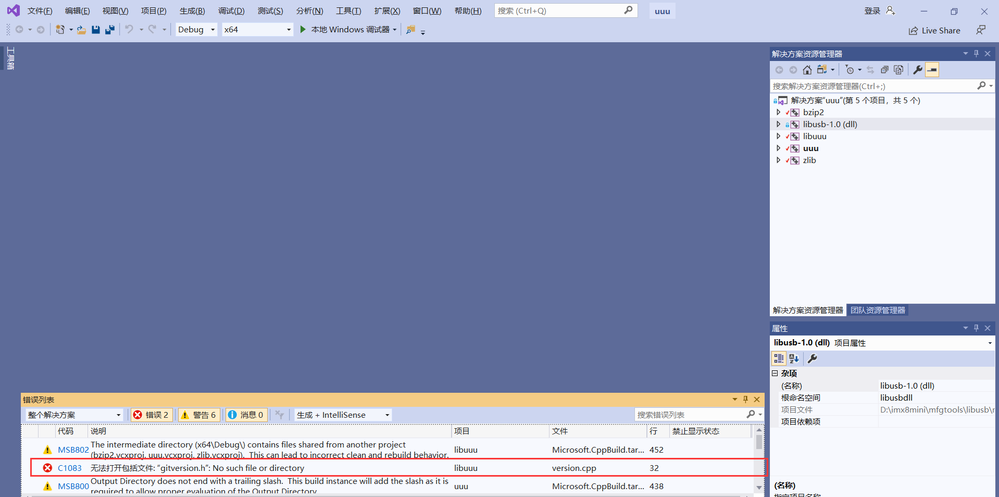

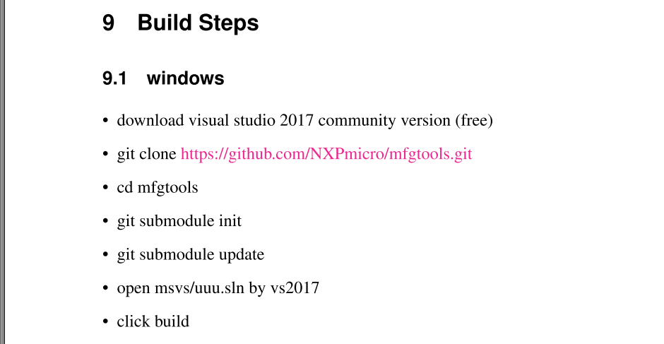

I am using imx8mmini
The programming method is uuu
I read uuu.pdf
but When I build
what should I do?

do you want to build UUU? you can download uuu tools, then use it directly

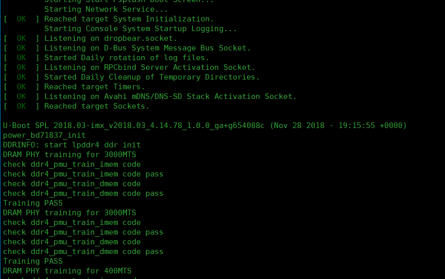

But after burning, the startup will restart continuously.

Thank you for your reply The restart has been resolved because type-C is connected to the PC. Power is not enough, I just switched to an adapter.

ok, tell me how did you program the image to your board, what command do you use, and what image version do you use? because I test latest version, couldn't reproduce your issue on my imx8MM board
