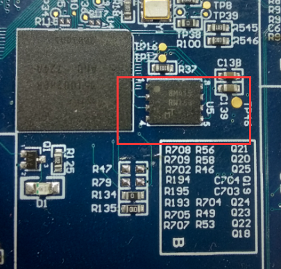

imx8mm linux 4.14.98 kernel log:
[ 1.683298] loop: module loaded
[ 1.690477] fsl-flexspi 30bb0000.flexspi: unrecognized JEDEC id bytes: 00, 00, 00
[ 1.697985] fsl-flexspi 30bb0000.flexspi: Freescale FlexSPI probe failed
[ 1.704759] fsl-flexspi: probe of 30bb0000.flexspi failed with error -2
[ 1.711483] slram: not enough parameters.
it is MT25QL256ABA,8MA15 RW163 。

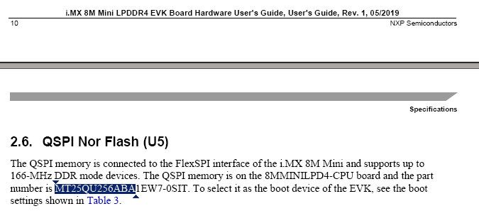

igorpadykov
Hi jianfei
MT25QL256ABA is 2.7-3.6V according to its datasheet
https://www.micron.com/-/media/client/global/documents/products/data-sheet/nor-flash/serial-nor/mt25...
EVK uses 1.7-2.0V  MT25QU256ABA1EW7 part.
igor

jianfeichang
Hi igorpadykov
      You're right.!Thank you very much!it is 2.7-3.6V!
