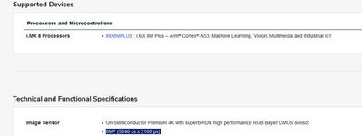

6,032件の閲覧回数
igorpadykov
this is resolution for daA3840 basler camera.
https://www.nxp.com/design/development-boards/i-mx-evaluation-and-development-boards/4k-dart-bcon-fo...

6,027件の閲覧回数
malik_cisse
Senior Contributor I
Hi Igor,
This is just the specification of Baslers 8MP sensor that ships with their ISP implementation.
As you said earlier in this thread, in "i.MX 8M Plus Applications Processor Reference Manual"
max. resolution is described in sect.13.1.2 Display Interface:
when one ISP is used, it supports:
• maximum resolution up to 12MP (4096x3072)
From that iyt should be possible to configure the ISP for 12MP.
6,023件の閲覧回数
igorpadykov
right, ISP max. resolution is described in sect.13.1.2 Display Interface
right, in driver code max. resolution of custom sensor is used (not ISP max. resolution)
-Source code in vvcam/v4l2/video/video.h:
#define VIDEO_FRAME_MAX_WIDTH 3840
#define VIDEO_FRAME_MAX_HEIGHT 2160
igor
