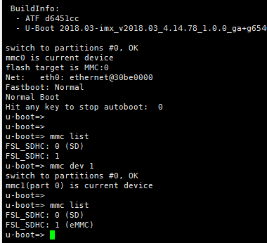

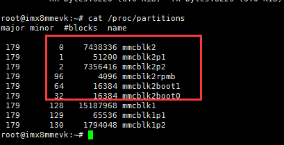

hi,
  sd boot:
        The emmc device can be detected in uboot mode and after the Linux system is booted.
 linux(sd boot):
uboot(sd boot):
Does this mean that the hardware(emmc ) is normal.

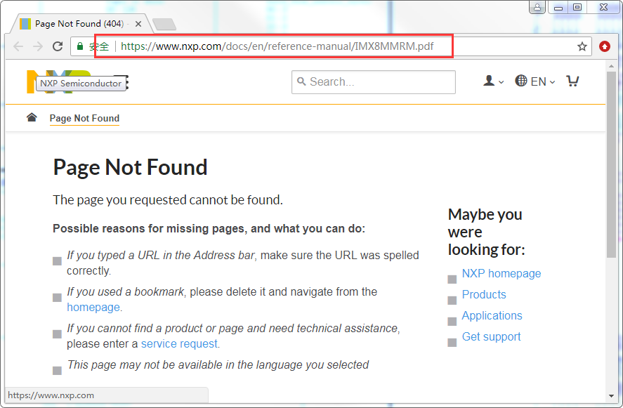

may mean poor signal integrity (noise) on emmc lines   ????
The link you gave could not be found.
