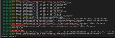

    Now i encounter a problem,and development progress is suspended here.
    I want to use the mipi csi 4lane to catch the video stream of fpga (no communication of i2c, only video stream - RGB888 800*800 30fps).
    I use the driver of ov5640(which has ran ok on my board with 2 lane, yuyv422, 30fps), and i ported and modified this driver. Delete most of not using function and interface.
Phenomena:
    And i sync made a test program of V4L2 that can be used normally. I can REQBUF、QUERYBUF、QBUF、STREAMON, but i alaways DQBUF failed. And i don't know where is error. No matter use v4l2-ctrl or use my v4l2 program all failed.
    V4L2 command:
v4l2-ctl --set-fmt-video=width=800,height=800,pixelformat=RGB3 --stream-mmap --stream-to=./ --verbose
And the log as below : i notice one point is the red frame. YUYV -> RGB3? My driver and app is all set RGB3, why it appear YUYV ???
The debug log as below:

Problem:
    Below i post my devicetree and my driver. Beside i find in the kernel version of 5.10.9, it use ISI dirver frame,i don't change anything about this beacause i am afraid of making error.
    I don't know if my devicetree or driver has any problem. Please help me and point out the problem, thanks a lot.
    And one thing i want to know is if should i set the clk, and how to set.
    Now i use the core of imx8mplus, Linux version 5.10.9. If you need any more file, details or whatever you need,I'll provide
