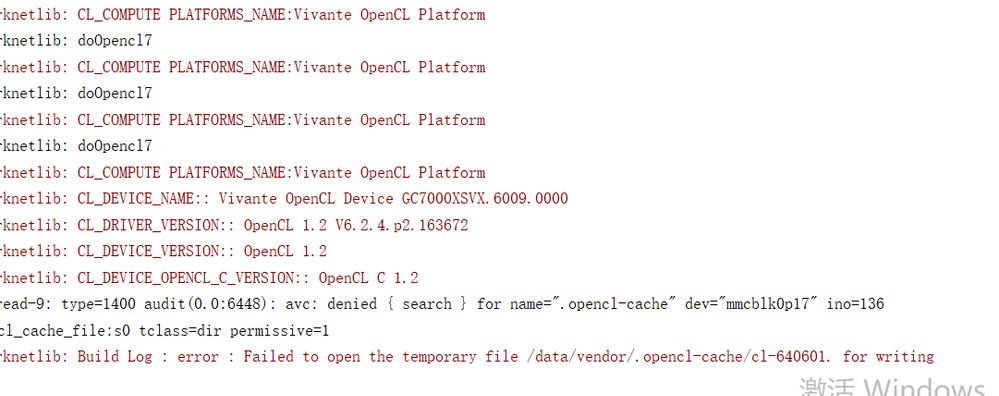

Hi , i use opencl at imx8 , i meet a error . when it run to the status=clBuildProgram(pgram,1,device,option,NULL,NULL), it will return error:CL_BUILD_PROGRAM_FAILURE . I use clGetProgramBuildInfo to get error, i can get this error:
Build Log : error : Failed to open the temporary file /data/vendor/.opencl-cache/cl-640601. for writing.

Hi , i do clGetProgramBuildInfo to get  the error information ,log is:Failed to open the temporary file "/data/vendor/.opencl-cache/cl-xxx" for writing.
My kernel is only:
#define KERNEL_SRC "\n" \
    "__kernel void hello_kernel(__global const float *a,__global const float *b, __global float *result) \n "\
    "{                                                                                                   \n "\
    "   int gid = get_global_id(0);                                                                      \n "\
    "   result[gid] = a[gid] + b[gid];                                                                    \n"\
I also do it on xiaomi6x, and i can run process.

Hi, i do "clGetProgramBuildInfo" to get error log,
the log is: error : Failed to open the temporary file /data/vendor/.opencl-cache/cl-612501. for writing,
statues is CL_BUILD_PROGRAM_FAILURE.
My kernel code is below. And i alse run it on xiaomi phone . I can run it success. How i can solve it ?
