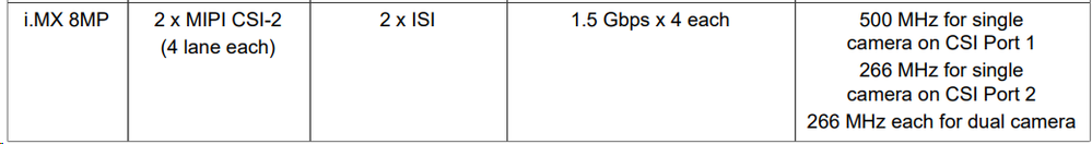

Make sure that you sensor is properly initialized, please refer to the following steps.
The user must make sure that the sensor can work properly through the following steps:
• Check all supply voltages.
• Check sensor MCLK frequency.
• Check reset and power sequence.
• Make sure that I2C communication between the sensor and SoC is functional.
• Make sure that sensor initialization registers are configured correctly.
• Check the sensor data lane and clock lane signals.
• Make sure that the sensor output stream is within the SoC MIPI capture capability (see Section 5 ).
2,234 Views
