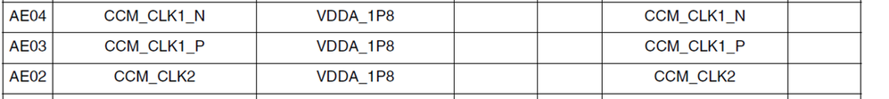

Hi All
Could you tell me the imx7d external clock source voltage range is 1.8V or 3.3V or other voltage range?
PS: the external clock means EXT_CLK1 or EXT_CLK2 ...etc.
Thanks.

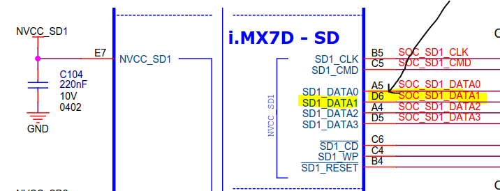

twhsueh
Hi Carlos,
    If "SD1_DATA1(pin D6)" is set to "CCM_EXT_CLK2" and NVCC_SD1 : 3.3V.
    OSC clock input can not exceed 1.8V too?
thanks,
1,805 Views
CarlosCasillas
Hi Felix,
When the pad is configured to SD card functionality, it will be tight to 3.3V rail; however, when using the pin as CCM_EXT_CLK, it will be tight to 1.8V rail.
As a final note, all of the CCM CLK pins are outputs (the N/P are differential outputs, and the other are single-ended).
Hope this will be useful for you.
Best regards!
/Carlos

CarlosCasillas
Hi Felix,
You could refer to section 5.3.2 of the i.MX7D Reference Manual, where it is mentioned oscillator pads should be supplied to 1.8V, and higher voltages must not be applied:
https://www.nxp.com/docs/en/reference-manual/IMX7DRM.pdf
Best regards!
