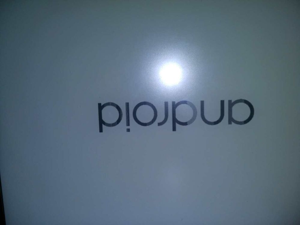

Dear All,
Thanks very much about the error:
such as
this is my  logcat:
root@sabresd_7d:/system/media/audio/alarms # logcat

Would you please help  me?

zhghua1103
Dear Igor,
I want to set the env for imx7d-epdc,
Would you please help me about the question?
With Best Regards
Joshua

igorpadykov
Hi Zhu
please check memory with ddr test
https://community.freescale.com/docs/DOC-105652
then rebuild Android uboot and Mfg Tools firmware with new ddr
settings, obtained from ddr test. Use for programming Mfg Tools script
mfgtool2-android-mx7d-sabresd-sd.vbs
http://www.nxp.com/webapp/Download?colCode=IMX6_L4-1-15_2-0-0_MFG-TOOL&appType=license&location=null...
igor
