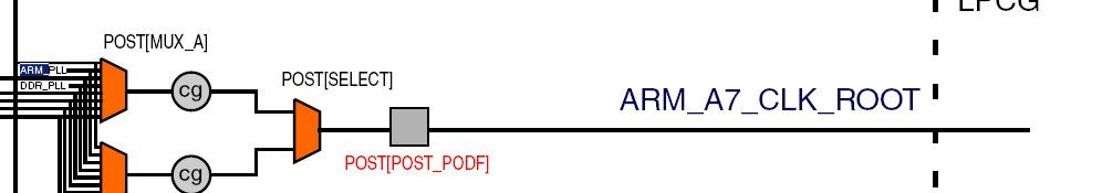

From the functional description of clocks, I think that ARM system clock frequency will be 800Mhz (5.2.6.1 Input Clocks in the reference manual, also uboot source code), but I don't understand the Clock Tree (5.2.4) where we can read:
ARM PLL -> /2  -> ARM_PLL_CLK
Does it mean that ARM PLL is 800 Mhz and ARM_PLL_CLK is 400 Mhz or that ARM PLL is 1.6 Ghz and ARM_PPL_CLK is 800 Mhz ?

on Clock Tree (5.2.4)  ARM_PLL and ARM_PLL_CLK both the same, 800 Mhz .
/2 produced by DIV_SELECT in CCM_ANALOG_PLL_ARM register.
