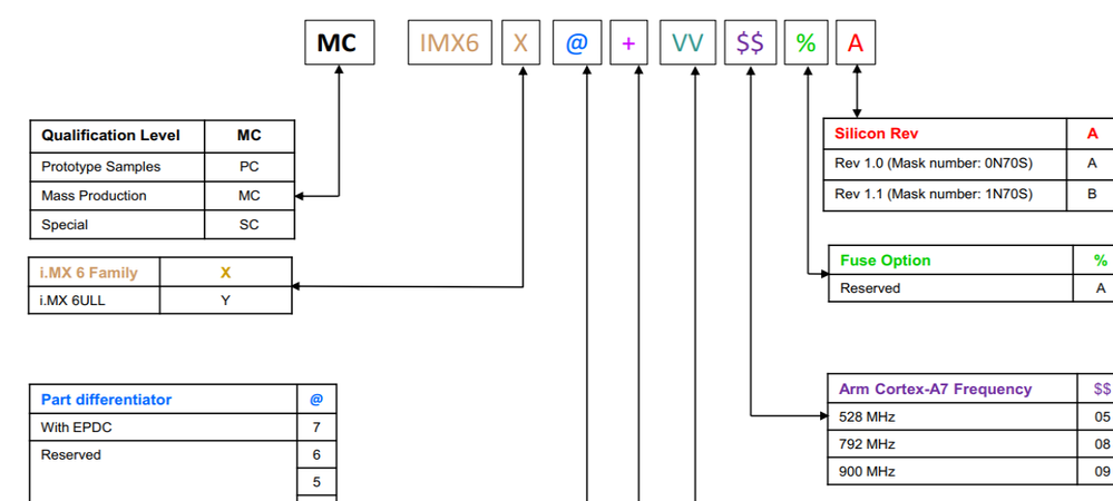

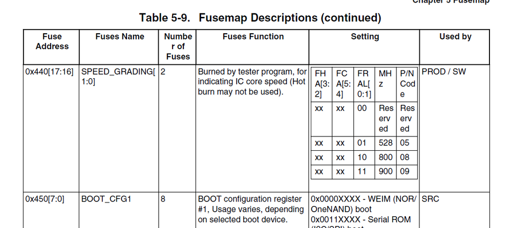

It has been clearly described in the last post. This cannot be burned by yourself. It is burned during production testing. I attach it again.
It says "Burned by tester program, forindicating IC core speed (Hotburn may not be used)."
Industrial part and Consumer part have different life times. This is in i.MX 6ULL ​​Product Usage Lifetime Estimates (AN5337).
If you force a higher frequency in the software than its grade defined, the life time will inevitably be shortened.
According to your idea, everyone should buy a cheaper Consumer part and burn it into an industrial part by themselves.
It will save lots of money including my running projects.
According to your idea, another case is just burn fuse of industrial part, it can run at 900M without life time impact.
Why NXP does not have 900M industrial part?
Why are there still different parts of different grades for sale?

lapohab
All frequencies are already in the device tree. The code will determine the chip type based on different fuses and then modify the DTB in real-time.
https://github.com/nxp-imx/linux-imx/blob/lf-6.6.3-1.0.0/drivers/cpufreq/imx6q-cpufreq.c
#define OCOTP_CFG3_6UL_SPEED_696MHZ	0x2
#define OCOTP_CFG3_6ULL_SPEED_792MHZ	0x2
#define OCOTP_CFG3_6ULL_SPEED_900MHZ	0x3
static int imx6ul_opp_check_speed_grading(struct device *dev)
	u32 val;
	int ret = 0;
	if (of_property_present(dev->of_node, "nvmem-cells")) {
		ret = nvmem_cell_read_u32(dev, "speed_grade", &val);
		if (ret)
			return ret;
	} else {
		struct device_node *np;
		void __iomem *base;
		np = of_find_compatible_node(NULL, NULL, "fsl,imx6ul-ocotp");
		if (!np)
						     "fsl,imx6ull-ocotp");
		if (!np)
			return -ENOENT;
		base = of_iomap(np, 0);
		of_node_put(np);
		if (!base) {
			dev_err(dev, "failed to map ocotp\n");
			return -EFAULT;
		val = readl_relaxed(base + OCOTP_CFG3);
		iounmap(base);
	 * Speed GRADING[1:0] defines the max speed of ARM:
	 * 2b'00: Reserved;
	 * 2b'01: 528000000Hz;
	 * 2b'10: 696000000Hz on i.MX6UL, 792000000Hz on i.MX6ULL;
	 * 2b'11: 900000000Hz on i.MX6ULL only;
	 * We need to set the max speed of ARM according to fuse map.
	val >>= OCOTP_CFG3_SPEED_SHIFT;
	val &= 0x3;
	if (of_machine_is_compatible("fsl,imx6ul"))
		if (val != OCOTP_CFG3_6UL_SPEED_696MHZ)
			imx6x_disable_freq_in_opp(dev, 696000000);
	if (of_machine_is_compatible("fsl,imx6ull")) {
		if (val < OCOTP_CFG3_6ULL_SPEED_792MHZ)
			imx6x_disable_freq_in_opp(dev, 792000000);
		if (val != OCOTP_CFG3_6ULL_SPEED_900MHZ)
			imx6x_disable_freq_in_opp(dev, 900000000);
	return ret;

My idea was to remove the other frequencies before blowing the highlighted fuse. You could try to only add the 792MHz node in DTS, if not, you should modify the fuses if your part number matches the 08 code.

userpas
Thank you both four replies. Now I understand where the limitation comes from.
The partnumber is MCIMX6Y2CVM05AB, therefore it is nothing to do here.
I've checked the fuses and results match with @lapohab described.
Regarding the software changes... I agree with @lapohab .
By default all frequencies are available in the Device Tree, therefore, if it is supported by the soc, those frequencies must appear in user space and it would be possible to change the CPU frequency in running time. There is no need to hardcode only one frequency in the Device Tree.
