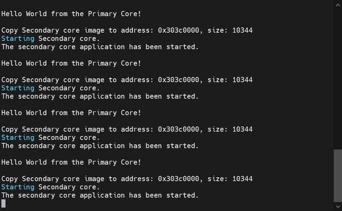

The following steps is what I tested based on the dual core project - hello world.
1. copy MIMXRT1189xxxxx_cm33_ram.icf from SDK_2_16_100_MIMXRT1180-EVK\boards\evkmimxrt1180\demo_apps\hello_world\cm33\iar  to SDK_2_16_100_MIMXRT1180-EVK\boards\evkmimxrt1180\multicore_examples\hello_world\cm33\iar
2. open the workspace file in SDK_2_16_100_MIMXRT1180-EVK\boards\evkmimxrt1180\multicore_examples\hello_world\cm33\iar and create a new configuration such as sram_debug based on flexspi_nor_debug.
3. edit the options in sram_debug:
a) C/C++ compiler->Preprocessor->defined symbols:
XIP_EXTERNAL_FLASH=0
XIP_BOOT_HEADER_ENABLE=0
b) Linker->Config->Linker Configuration File: $PROJ_DIR$\MIMXRT1189xxxxx_cm33_ram.icf
4. open workspace file in C:\install\SDK Archive\SDK_2_16_100_MIMXRT1180-EVK\boards\evkmimxrt1180\multicore_examples\hello_world\cm7\iar, and build
5. switch to cm33 workspace and build and click the button for Download and Debug
6. two debug sessions will come out and one for cm33 the other for cm7, start cm33 debug at first and then start cm7 debug.
BTW, IAR 9.60.3 was used in this test, and debug interface was CMSIS DAP.
Hope that helps,
Kan
