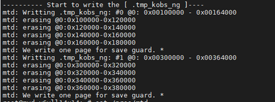

Hi,I checked the chip manual and found that efuse has a default boot count of 2. Does this mean that uboot is stored twice in the bootrom code?
In addition, when I use kobs-ng to write uboot, I also find that u-boot.imx is written to two addresses (such as 0x100000 and 0x300000). If I use flash_erase to erase one of the two addresses, the hard reset can start normally. It cannot start until the uboot is erased from both addresses
root@y6ull14x14:~# flash_erase /dev/mtd0 0x100000 1
Erasing 128 Kibyte @ 100000 -- 100 % complete
