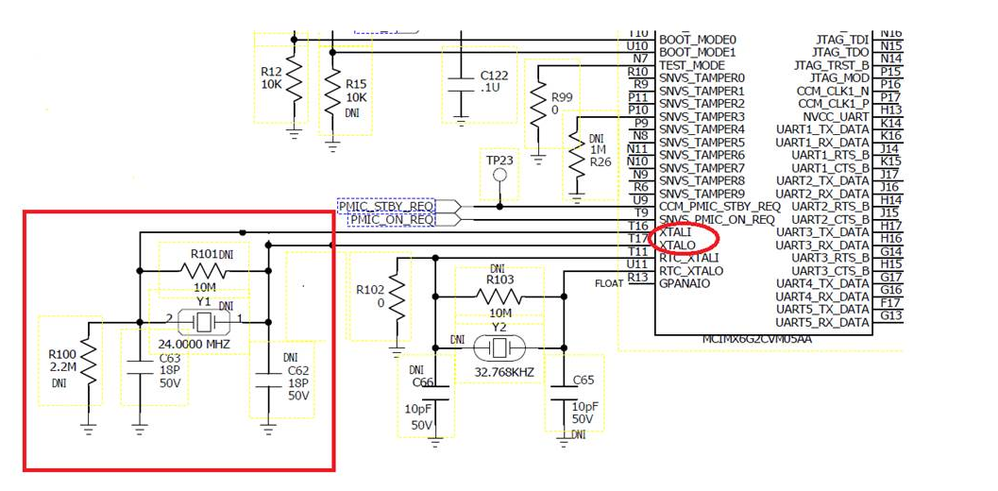

I'm using imx6ul processor. I have changed the hardware to use crystal with internal biasing circuit to work as oscillator.
as per imx6ul RM, when the crystal is identified on the solder bumps, the biasing circuit should be auto enabled. but it is not running it seems. I'm still not seeing desired 24 Mhz in the solder bump when probed with a scope.
Am i missing any SW settings to see the oscillator [with internal biasing circuit enabled] running?
any suggestions / guidance is most welcome. Thanks.

    We are using IMX processor “MCIMX6G2AVM05AB” in our design and from datasheet we are unable to find crystal specification for 24Mhz.
   We would like to get the recommended load capacitance and reference circuit. Please let us know whether do you see any problem with the crystal circuit shown below. Kindly support

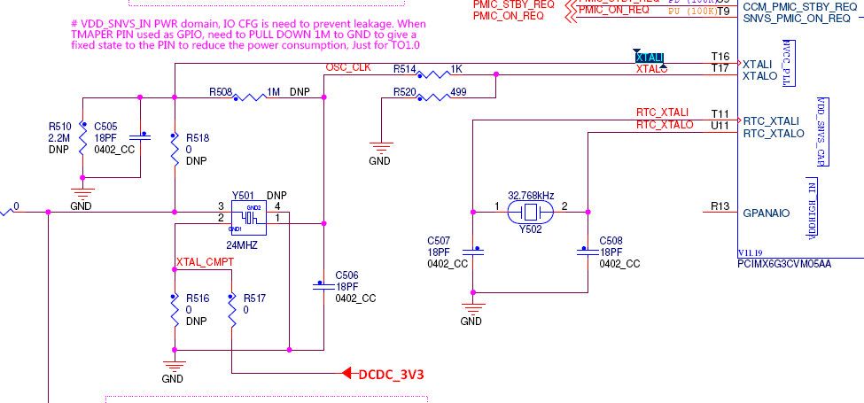

igorpadykov
Hi Anantha
load capacitance shoud be taken from datasheet of crystal.
For reference schematic one can look on i.MX6UL EVK schematic
Schematics (1)
MCIMX6UL-EVK_DESIGNFILES
Design files, including hardware schematics, Gerbers, and OrCAD files. (REV 0)
http://www.nxp.com/products/sensors/gyroscopes/i.mx6ultralite-evaluation-kit:MCIMX6UL-EVK?fpsp=1&tab...
May be useful to check NVCC_PLL which powers 24MHz oscillator (OSC24M).
igor

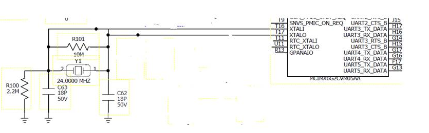

anantharamachan
Hi Igor,
Thanks for your reply.
We are using 24Mhz Crystal part number “ECS‐240‐18‐23A‐EN‐TR” for the processor part “MCIMX6G2AVM05AB”.
   We would like to know whether the below crystal circuit is compatible. Also Please help to get the file “Power_Calculator.xlsb” file.

igorpadykov
Hi Anantha
please refer to example from i.MX6UL EVK and attached file.
C62,63 should be obtained from crystal datasheet.
igor

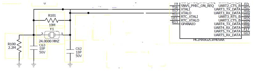

anantharamachan
Hi Igor,
I’m unable to open this file attached in application note “EB830”.

anantharamachan
Hi Igor,
will check  the hardware settings.
