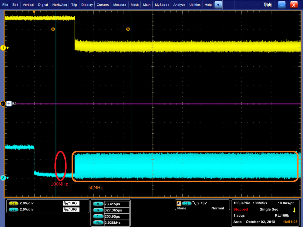

Hello Yuri‌,
Sorry for my late reply.
I measured both MMC_CLK(ch2:Cyan) and MMC_CMD(ch1:Yello) with DDR fast boot setting.
(Shorted R712 : BT_CFG2_7 of SABRE-SD to set MMC4.4 8 or 4-bit DDR mode)
After power on, before start to copy 4KB data from BOOTPART1 to OCRAM,
To copy BOOTPART1, MMC_CLK work with 50MHz(Orange).
But befor copy it, MMC_CLK drive with 100MHz(Red).
What is it doing?
Is it a UHSI calibration function?
Ishii.

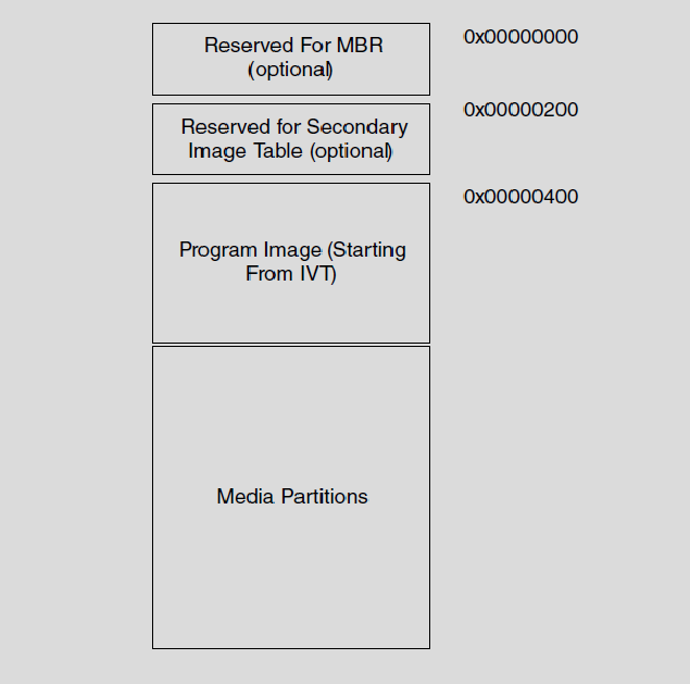

But what I want to know is how this partition is used in boot ROM.
In MMC/SD-Card boot, boot ROM copy 4KB boot image from sector 2 of MMC/SD card to internal RAM.
So user area(main storage) are parted to 4 area.
    user area      : MBR(sector 0,1) + u-boot(IVT+DCD) + FAT(zImage + .dtb file) + Ext4(Linux file system)
If eMMC4.3(or higher) use as boot device, it can use "Boot area partition" separated from the user area.
I think that it will parted as following.
    user area      : MBR(sector 0,1) + Ext4(Linux file system)
    boot partition : IVT+DCD + zImage + .dtb file
Is it correct?
If so, boot ROM in eMMC boot copy 4KB boot image from boot partition(in eMMC) to internal RAM(in i.MX6).
Is it correct?
Currently, my customer use plugin image, does it use with eMMC4.3(or higher) boot operation?
Ishii.

Yuri
Hello, Ishii!
   According to Figure 8-17 (Expansion device structures layout) of i.MX 6Dual/6Quad RM, Rev. 4, 09/2017,
IVT, DCD, and the Boot Data structures are located separately (outside of device partitions).
Yuri.
