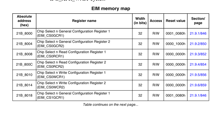

the eim register is :
i want to change the register value, but i can't read or write it wen i ioremap the phy_adr.

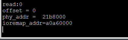

i built a mode ,when i insmod it :
#define  ADDR_PHY 0x21B8000
void read_phy_addr(int offset)
  static struct resource  *my_mem;
  printk("offset = %d\n",offset);
  my_mem = request_mem_region(ADDR_PHY + 0x4000 * offset, 0x4000, "testPF");
     if (my_mem == NULL) {
        printk("failed to get memory region\n");
        return -ENOENT;
  else
  printk("phy_addr = %8x\n",ADDR_PHY + 0x4000 * offset);
    void __iomem *plx_membase;
    plx_membase = ioremap(ADDR_PHY + 0x4000 * offset, 0x4000);
    if(NULL == plx_membase){
    printk("ioremap error\n");
  printk("ioremap_addr=%lx\n",(u_long)plx_membase);
printk("print_out: %d\n",readl(plx_membase));
  printk("+++++++++++++++++++++\n");
  iounmap(plx_membase);
  release_mem_region(ADDR_PHY + 0x4000 * offset,0x4000);
the result is:
the program deadlock.
i have tried other phy_addr.
some can read the value ,and some can't.

igorpadykov
Hi Yi
please check that CCM register CCM_CCGR6
enables clock (eim_slow clocks) for EIM module.

半醒的狐狸
Hi igorpadykov
thanks for you help,i read the CCM_CCGR6,found the eim_slow clocks bit is disable.
i can read and write the weim register after enable the clocks.
thanks again for you help!
