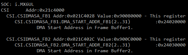

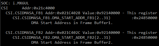

hi,
I use imx6ul + yocto-4.1.15-ga to develop  product, when debuging csi module + ov9712(parallel) on gated mode,  we found image we get sometimes is ok.
But sometimes we can't get anything, at this time I use memtool to check CSI register, I found CSI.CSIDMASA_FB1 is equal to CSI.CSIDMASA_FB2, but if the image is OK, these two registers value is different, and these two registers value is only the difference point between  2 situation.
I attach the memtool result.
Pls help me to solve it.
this is we get correct image.
this  we can't get anything, no data,

hi I check it.  when csi driver probed, these two reg value is 0, and  app start request it has change like this
// csi probe
CSI.CSIDMASA_FB1 Addr:0x021C4028 Value:0x00000000
CSI.CSIDMASA_FB2 Addr:0x021C402C Value:0x00000000
these info printed by memtool when I use my custom app to capture
// app start capture
CSI.CSIDMASA_FB1 Addr:0x021C4028 Value:0x90080000
CSI.CSIDMASA_FB2 Addr:0x021C402C Value:0x900C0000
CSI.CSIDMASA_FB1 Addr:0x021C4028 Value:0x92100000
CSI.CSIDMASA_FB2 Addr:0x021C402C Value:0x92180000
and so much info is correct and then
CSI.CSIDMASA_FB1 Addr:0x021C4028 Value:0x92180000  //  fb1 addr is same as fb2 addr, why??
CSI.CSIDMASA_FB1 Addr:0x021C4028 Value:0x92180000 // after all the print info is like this
Later I exit my app, these registers value is 0x00000000, I think it's right, csi driver clean it.
Could you explain why it happen?
