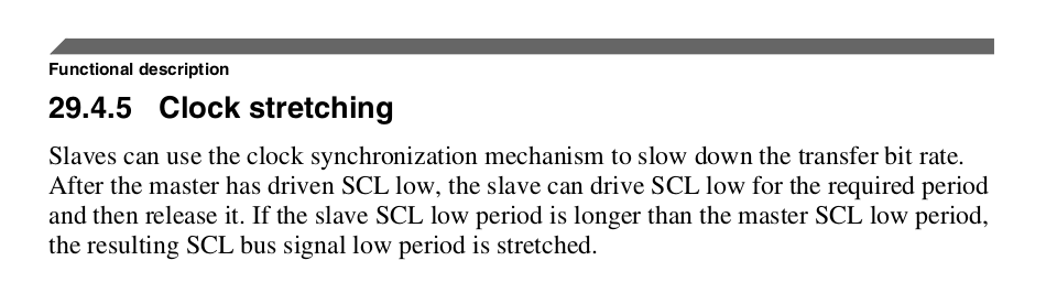

Does imx6ul's i2c bus support clock stretching function?
How to set?
I was affected by clock stretching when communicating with mcp9600.
How can I match it well?

Hi Yu Bocky,
Referring to the RM of imx6UL:
