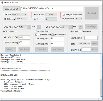

deepaktajanpure
When we click on Calibration it is getting hang. Please see DDR Stress Tester snapshot and log file attached herewith

pengyong_zhang
Please use the following setting:
