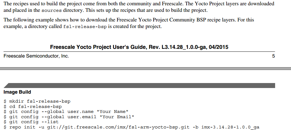

Hello everyone
I find a problem but i dont know why.
i want to build  Yocto Project Setup
i knock the last command
why can't find  imx-3.14.28-1.0.0_ga ? i dont know how to set up this project.who can give me some advices ......
1,528 Views
jimmychan
it should be imx_3.14.28_1.0.0_ga
you can find all the branch name in here: linux-2.6-imx.git - Freescale i.MX Linux Tree
