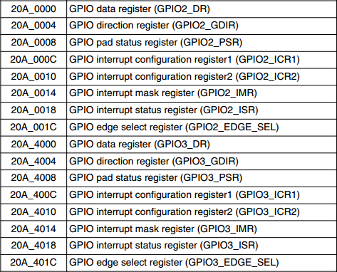

   I use imx6sololite's gpio interrupts in our custom board. I meet some probloms as follow:
  configuration:
  PIN: GPIO2_16 :
temp = 0;
temp = readl(GPIO2_GDIR);
temp &= (~(1 << 16));
writel(temp, GPIO2_GDIR);
temp = 0;
temp = readl(GPIO2_ICR2);
temp |= (1 << 0) | (1 << 1);
writel(temp, GPIO2_ICR2);
temp = readl(GPIO2_IMR);
temp |= (1 << 16);
writel(temp, GPIO2_IMR);
PIN:GPIO3_15
temp = 0;
temp = readl(GPIO3_GDIR);
temp &= (~(1 << 15));
writel(temp, GPIO3_GDIR);
temp = 0;
temp = readl(GPIO3_ICR1);
temp |= (1 << 31) | (1 << 30);
writel(temp, GPIO3_ICR1);
temp = 0;
temp = readl(GPIO3_IMR);
temp |= (1 << 15);
writel(temp, GPIO3_IMR);
GPIO3_15 can enter interrupt funcution,working normal,but GPIO2_16 not working,could you give me some advice...
Thanks........

Hi wei
please check if this pin is not used in other way (for example by other module
or in uboot), also one can attach jtag and check its register settings.
igor

Thanks for your answer,but i only regeister gpio function  and read back,i under uboot read gpio2_16 and gpio3_15
gpio2_16:  020a0004: 00000000
                  020a0010: 00000003
                  020a0014: 00010000
gpio3_15:
                 020a4004: 00000000
                 020a400c: c0000000
                 020a4014: 00008000
gpio only regeister interrupt function,but gpio3 working nornal ,gpio2 not working,please help me.......
