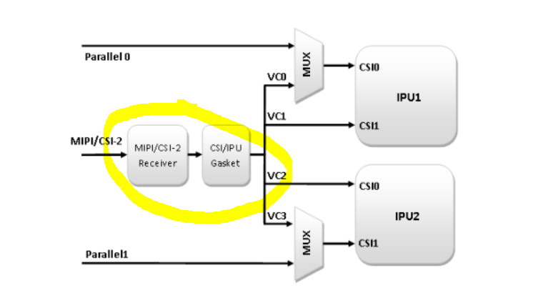

     The development board I use is IMX6Q.
     The yellow circle in the figure above is the part where mipi-CSI connects with IPU-CSI.
      Have the following questions:
      When using the MIpi-CSI camera, imX6Q should receive data using the MIpi-CSI interface.Mipi-csi receives the data and passes it to the IPU-CSI module.Ipu-csi working modes include Gated Clock Mode, non-gated Clock Mode, CCIR656 Interlace Mode and CCIR656 Progressive Mode. In this case, which mode should IPU-CSI work in?
