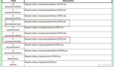

Dear ,
        I have do  test on system deep sleep and wake-up,when system wake up,the mipi lcd can't show anything ,kernel log prompts that " mipi dsi phy lock timeout    failed to init mipi lcd"
        add debug code trace_printk as below
    If  no phy lock time out, the MIPI_DSI_PHY_STATUS readed  value is 0x15BD,
      If  phy lock time out, it prints 0x1528
      refer to imx6DQRM.pdf,when phy lock timeout ,lane 0 and lane 1 not in stop state
     Anyone can help me ,why data lane 0 and lane 1 not in stop state,and phy lock timeout

leeshuai
Dear  igorpadykov
 bsp IMX6_M6.0.1_2.1.0_ANDROID_DEMO_BSP  sabresd not  automotive
panel  TRULY WVGA LCD Modue(TFT 720 x1280)
first  phy lock time out ,  then mipi lcd failed,
that is before mipi lcd init,mipi dsi already init failed,so why mipi dsi phy lock timeout
