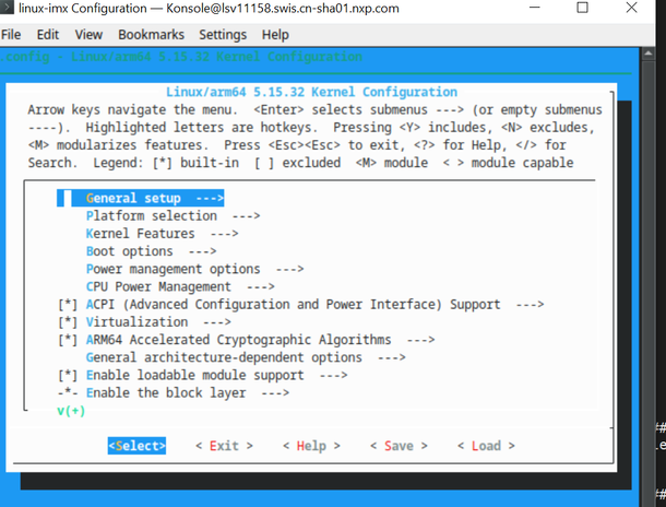

Hello support team,
MACHINE=imx6qdlsabresd DISTRO=fsl-imx-wayland source ./imx-setup-release.sh -b build
bitbake imx-image-base
once the OS image build,how to activate the make menuconfig, i want to customize the settings?
can you provide me the documents
Thanks.
2,567 Views
joanxie
don't have any document for this simple command, when you use the command, did you get the picture as below?
 if yes, you can enable or disable them in the kernel configuration, then you choose "save" after you set, in the end, use the command "bitbake linux-imx -f" to build the kernel again

bitbake linux-imx -c menuconfig

Do you have any document for menuconfig
loading and saving the config file
thanks

joanxie
try to use command "bitbake linux-imx  -c menuconfig "
