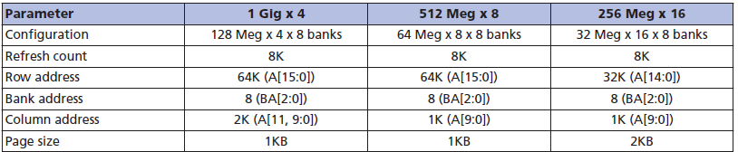

Our custom imx6Q board all functions/components are workable.(The ddr use MT41K128M16*4)
Now, we want to use MT41K256M16(DDR3-1866) instead of MT41K128M16 that imx6Q use it on demo board.
The ram size upgraded from 1GB to 2GB. (MT41K256M16*4)

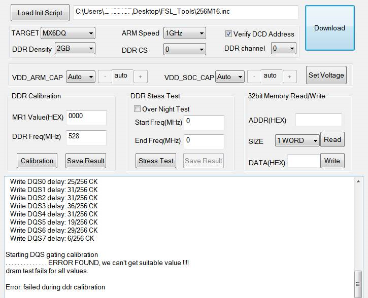

As we used GUI_DDR_TEST_TOOL v2.5.2 or DDR_STRESS_TESTER v1.0.3 to test MT41K256M16, we got some problem as below
We are receiving an error message - " Failed to send calibration command".
But, we used GUI_DDR_TEST_TOOL v2.5.2 to test MT41K128M16 on our custom board, it was successful.

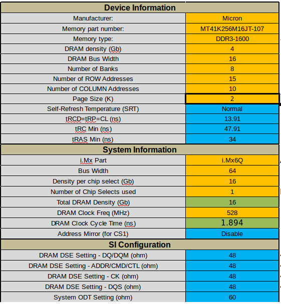

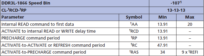

Here is our setting parameter for MT41K256M16 (Memory type: DDR3-1866)
About MT41K256M16 parameter is as below. (256Meg x 16)
We also tried to use DDR_STRESS_TESTER v1.0.3, but it doesn't work either.
Could you can give me some advice?

   Please try parameters for DDR3L-1066, since i.MX6 real frequency is 528 MHz.

nicehsieh
Hi Yuri,
     We tried, but it still doesn't work.

Have You modified initialization script in the stress test to meet new DRAM
parameters ?
