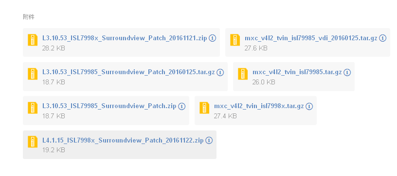

liangfeng_0824
Which patch should I use?

liangfeng_0824
I now use the i.MX6DualLite  android6.0.1  kernel software version is :
Please confirm which patch I should use now?
