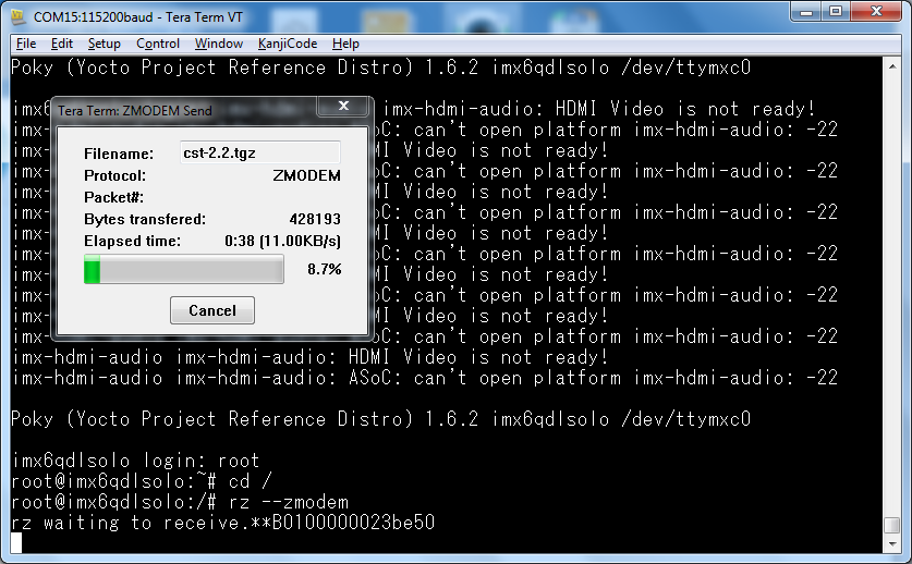

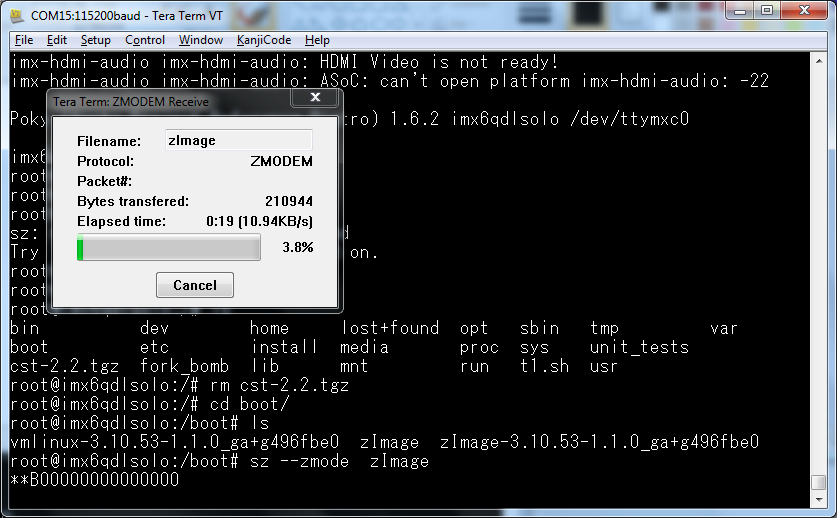

Here is the test on the i.MX6 sabreSD board.
rz:
sz:

ktulhuuchiha
Thank you for your answer.
It helps me to understand that I used zmodem in wrong way.
Thus I`ve also found that zmodem worked well on imx6 uarts.
