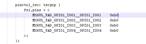

i am using imx6ul board,I found a very large touch jitter,How can I improve it?my VDDA_ADC_3P3 is connected to DCDC_3V3

Do you use the i.MX6UL on-chip analog touchscreen interface? If so, the answer is: yes, supplying the ADC VDDA_ADC_3P3 supply voltage from a switching DCDC converter (DCDC_3V3) may cause high amount of ADC unstability. To avoid it, follow the original i.MX6UL EVK board connection, where VDDA_ADC_3P3 is supplied form LDO (not switching DCDC converter) produced VLDO_3V3 voltage.
Another point is that for proper ADC operation you have to configure the used ADC input pads (GPIO1_IO00 to GPIO1_IO04) IOMUX as GPIO inputs with pull/keepers disabled.

1,yes i used the i.MX6UL on-chip analog touchscreen interface,ichange the VDDA_ADC_3P3  to LDO,but not very much improved,I found that the larger the screen the more powerful shake。
2,the ADC GPIO configuration as follows:(reference the imx6ul-14x14-evk)
