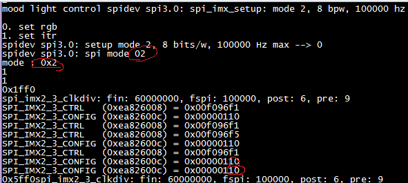

I am trying to use mx6q spidev to control a dac chip.
The chip requires CPOL to be enabled so that SCLK is high at idle and starts out with a falling edge.
I have set the SPI_MODE_2(CPOL =1 , CPHA = 0) from user space via ioctrl to the /dev/spidevX.X and was able to read back the same mode from SPI_IOC_RD_MODE. Though when I send spi data, the oscilloscope wave shows that CPOL remains zero at the idle and starts with a rising edge.
Is there any other setting required to change SPI_MODE?
any help would be appreciated.

how are you setting CPOL? If you set CPOL using memtool does it work?

In the userspace, I open the /dev/spidevX.X and set the mode to be "SPI_MODE_2", which is for CPOL = 1.
After setting, I read the mode back to verified if it is correctly set.
ioctl(fd, SPI_IOC_WR_MODE, &mode)
ioctl(fd, SPI_IOC_RD_MODE, &mode)
I also added some debug code in imx_spi.c and check if the ECSPI register value change and verified that ECSCPI_CONFIGREG 's SCLK_POL bits are correctly set to be idle high.

Can you please try setting it with the memtool and let me know if it changes?
