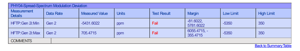

      But the test fail on "Spread-Spectrum Modulation Deviation"
    what is the possible cause about it ?
   The "spreed-spectrum" is enabled in " IOMUXC_GPR13".

Hello jiang,
have you checked whether the reference clock applied to SATA already uses spread spectrum?
If the applied RefClk is already spread spectrum, this bit must be deasserted.

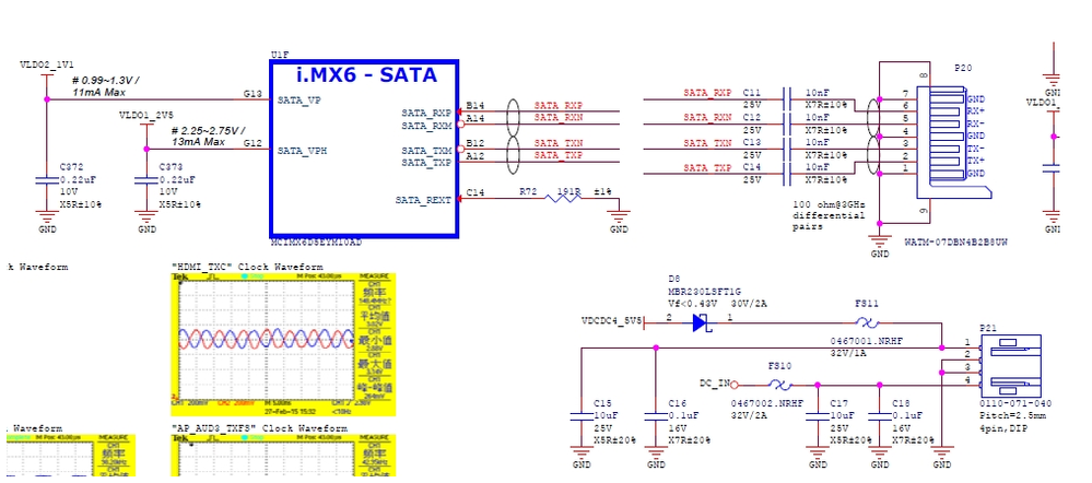

1. Do you use our reference board or do you have your own custom board?
In case you have a custom board:
a) Have you refered to our reference boards how the SATA interface is designed?
b) Have you refered to our HWDG, RM and met all the layout criteria (impedance control etc.?)
c) Have you checked whether your crystal selection meets the required PPM for SATA?
On our reference boards we have passed the Gen2 validation, including the Spread Spectrum Deviation test. I am in process of investigating if we used the default ref clock (PLL6 - ENET PLL) for the validation or some else (improbable but to be sure).
2. I did some digging and found another customer who had troubles passing the validation. This worked for them:
Set GPR13 to 0589ACFC (set SATA_PHY_2 to 1.24 V). I suggest you try it.
Jan

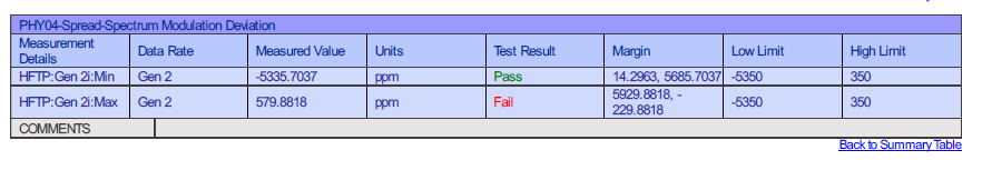

     2. It does help by set  SATA_PHY_2 to 1.24V, but still not pass.
     1. it used my own board, it's reference to the " reference board"

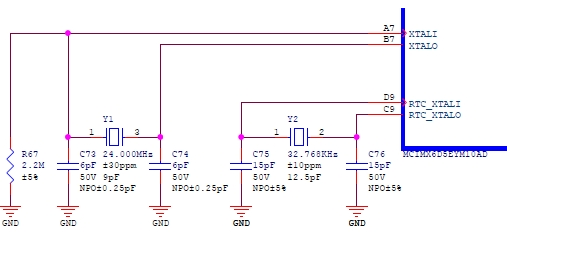

The ppm of 24Mhz is 30.

The schematic looks fine, crystal is precise enough. Is the layout ok?
Use the following recommendations for the SATA.
  • SATA differential pairs should have a differential impedance of 100.
  • Each differential pair should be length matched to ± 5 mils.
  • Follow standard high-speed differential routing rules for signal integrity.
Jan

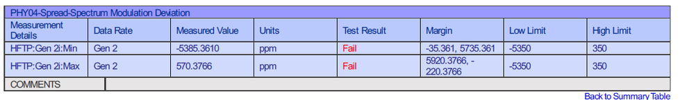

         Thanks for you support. The test have passed by using external clock as PCIE, bypass PLL6.

      I and jiang used the default ref clock (PLL6 - ENET PLL) ,set  SATA_PHY_2 to 1.24V,and the layout is ok to test.
       “HFTP: Gen 2i:Min”  is Pass ,But the “HFTP: Gen 2i:Max” is fail.
       PLL6 - ENET PLL and Controls the frequency of the ethernet reference clock vaule is 100MHz
       root@imx6qsabresd:~# ./testscript/can/memtool -32 0x20c8160 1
       Reading 0x1 count starting at address 0x020C8160
       0x020C8160: 8000040B
root@imx6qsabresd:~# ./testscript/can/memtool -32 0x20c80e0 1
Reading 0x1 count starting at address 0x020C80E0
0x020C80E0:  80182002
        SATA_PHY_2 value is 1.24V
root@imx6qsabresd:~# ./testscript/can/memtool -32 0x20e0034 1
Reading 0x1 count starting at address 0x020E0034
0x020E0034:  0593E4FE
Corey
