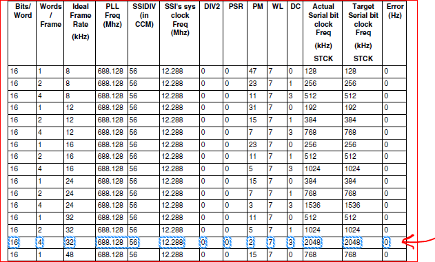

sumit8915
Hi Saurabh,
After using the SSI2 controller instead of SSI1, We are able to get the PCM Clock of 2.048Mhz and Frame Sync of 32Khz, But  the SLIC IC supports PCM Clock rates of 1.024MHz, 1.536MHz, 2.048MHz. 3.073MHz, 4.096Mhz, 6.144MHz and 8.192Mhz with a Frame SYNC of 8KHz.
We have changed the "SSIx_SRCCR" register corresponding to SSI2 controller of i.MX6 processor with values of "0x00007F03" to make frame sync freq of 8Khz, But still no change, But we did not see any change in the Frame sync clock ,
Here in the below table we have used with marked configuration.
Do you have any idea, how we can get the frame Sync of 8Khz.
Sumit
