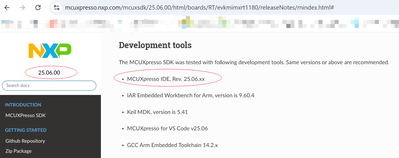

1:  MCUXPresso IDE version and SDK lib version should be compatible.

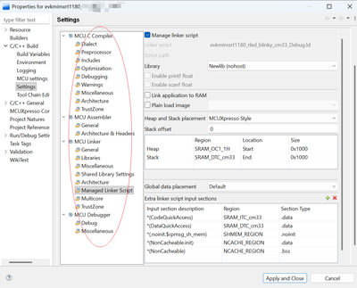

2:   Have you checked for differences in the Project -> Properties -> C/C++ Build settings between the two projects?

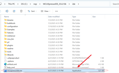

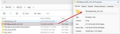

2: If step1 still not work, please try to copy MCUXpressoIDE_25.xx file from your PC(OK) to your PC(NOK)
open mcuxpressoide.exe, then create a new workspace, and  try to debug.
