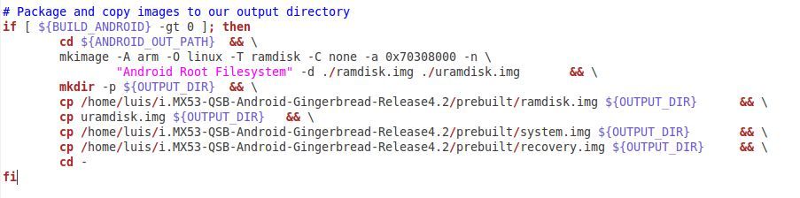

As I could understand when I did the steps of release notes4.2 build process just copy ramdisk.img, system.img & recovery.img. from "prebuild" folder to "out" folder. (You can see it in a comment of the script build_android.sh "# Package and copy images to our output directory")
If you look at build_android.sh carefully, at the bottom of the script, it builds the android stack using
    "make PRODUCT-........" line
HERE THE SCRIPT ASSUMES all the image files are created by make command inside the directory ${ANDROID_OUT_PATH}
so while doing  "# Package and copy images to our output directory"
it goes to ${ANDROID_OUT_PATH} using 'cd' command and then fires 'mkimage'
now in mkimage command it refers "./ramdisk.img" in current directory based on above said assumption.
and then due to same assumption it tries to copy all images from ${ANDROID_OUT_PATH} to ${OUTPUT_DIR}
I do not remenber when those images were created but for sure those images were created before run build_android.sh into prebulid folder.
 yes... these are already built images and I found those inside a tarball (i.MX53-QSB-Android-Gingerbread-Release4.2.tar.bz2)

LuisRivera
Hi Mangesh, sorry for the delay

LuisRivera
Hi Mangesh
I added the complete route to ramdisk.img, system.img & recovery.img because other wise this images could not be found.
I don't understand very well what you mean in your second question, do you refer about the original location of building images?

LuisRivera
Hi Carl,
I don´t understand which one of the two problems you mean, but regarding to the script "download_android.sh" was solved using another internet connection different to the server of the work because of server firewall; so you can run this script connected into a coffe shop or something like this as Michael suggested.
And about the problem with the script "bulid_android.sh" I fixed the problem adding the complete route of ramdisk. img into the script as follows:
I had to do the same with system.img & recovery.img as you can see.
I hope it helps you.
Also and it's to important "Do not forget to download and install JDK6 in your host machine" because without that Android binary image will never work.
