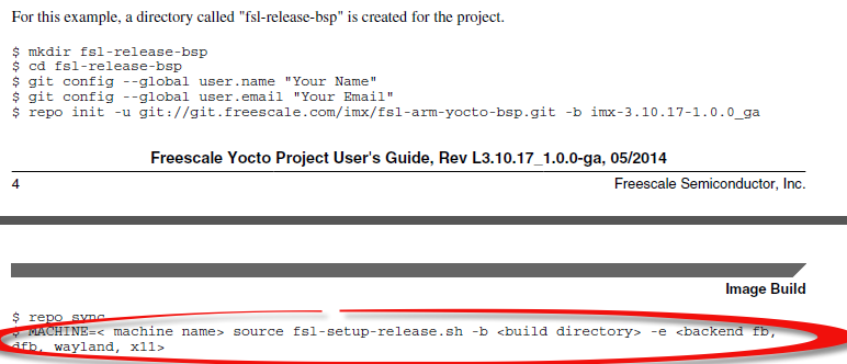

The following is the procedure using to build
1   mkdir yocto_build
2  mkdir fsl-release-bsp
3   cd fsl-release-bsp/
4  git config --global user.name shravan
5   git config --global user.email shravan.s@pptech.com
6  git config --list
7   repo init -u git://git.freescale.com/imx/fsl-arm-yocto-bsp.git -b imx-3.10.17-1.0.0_ga
8  repo sync
9 . setup-environment
10   DISTRO=poky MACHINE=imx6qsabreauto source fsl-setup-release.sh –b build
11  bitbake fsl-image-x11
Below Error I am facing

/bin/sh: arm-poky-linux-gnueabi-g++: command not found
make[2]: *** [.obj/release-static/HTMLCanvasElement.o] Error 127
make[2]: Leaving directory `/home/carplay/Ext_Part/fsl-release-bsp/build/tmp/work/imx6qsabreauto-poky-linux-gnueabi/qt4-x11-free/1_4.8.5-r0/qt-everywhere-opensource-src-4.8.5/src/3rdparty/webkit/Source/WebCore'
make[1]: *** [sub-WebCore-make_default-ordered] Error 2
make[1]: Leaving directory `/home/carplay/Ext_Part/fsl-release-bsp/build/tmp/work/imx6qsabreauto-poky-linux-gnueabi/qt4-x11-free/1_4.8.5-r0/qt-everywhere-opensource-src-4.8.5/src/3rdparty/webkit/Source'
make: *** [sub-webkit-make_default-ordered] Error 2
Please suggest me how to fix this build error .

Hi Shravan,
have you added extra packages in config file?
what do you get if you try the following?
repo sync
DISTRO=fsl-imx-x11 MACHINE=imx6qsabreauto source fsl-setup-release.sh –b build
Please note that running fsl-setup-release.sh resets the configuration, therefore . setup-environment is not necessary.

shravansundarra
Hi  Carlos_Musich,
With
With this option ,
Getting below error
carplay@CPU-307U:~/Ext_Part/fsl-release-bsp/build$ bitbake fsl-image-x11
ERROR:  OE-core's config sanity checker detected a potential misconfiguration.
    Either fix the cause of this error or at your own risk disable the checker (see sanity.conf).
    Following is the list of potential problems / advisories:
    Your version of bblayers.conf has the wrong LCONF_VERSION (has 6, expecting 5).
Please compare the your file against bblayers.conf.sample and merge any changes before continuing.
"meld conf/bblayers.conf /home/carplay/Ext_Part/fsl-release-bsp/sources/poky/meta*/conf/bblayers.conf.sample" is a good way to visualise the changes.
DISTRO 'fsl-image-x11' not found. Please set a valid DISTRO in your local.conf
ERROR: Execution of event handler 'check_sanity_eventhandler' failed

Carlos_Musich
Hi Shravan,
I was confused, and I can see that so are you.
The command to build images with kernel 3.10.17 and older use a different format which is different to the one you are using.Please see below
Please try
MACHINE=imx6qsabreauto source fsl-setup-release.sh -b build -e x11
Carlos
