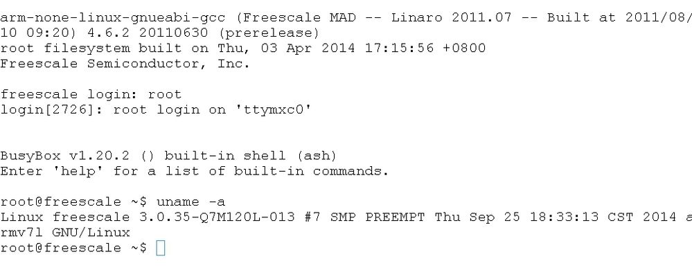

Hi all,
I followed the latest Freescale Yocto Project User's Guide build my image.
But when I use uname -a it shows up kernel 3.0.35
How can I change my kernel to 4.1?

4,607 Views
yichen
I followed the documentation you gave.
Or there is another way to know my kernel version?

yichen
Hi Yuri
Thanks for your image
But still the same.
Is that caused by u-boot?
Because I have an emmc on my board. I don't know it will effect my kernel version or not?

Yuri
1.
from just built Linux :
root@imx6qsabresd:~# uname -a
Linux imx6qsabresd 4.1.15-1.1.1+gd5d7c02 #1 SMP PREEMPT Tue May 17 16:33:36 OMST 2016 armv7l GNU/Linux
2.
   Looks like really eMMC located kernel and filesystem are used in the case.
Please check carefully Your boot settings and U-boot environment.
Difference between eMMC and SD is just port number.
Yuri.

yichen
Hi Yuri,
Thanks for your help.
It is emmc's problem.
I change it to boot from sdcard to solved these problem.
