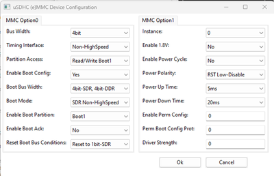

I have found a way to boot from the eMMC boo1 partition with MIMXRT1170-EVKB. Below you can find the steps to make it work:
  1. Set target setup as follows
  2.  Click the “Boot device Configuration” button and set all the fields as presented below
  3.  Set the MiMXRT board in SDP Mode and load the image
  4. Power off the board
  5. Set the boot switches as follows - sw1 "0.0.1.0" sw2 "1.0.0.0.0.0.0.1.0.0"
  6. Power on the board
  7. The software loaded to the eMMC boot 1 partition should start
