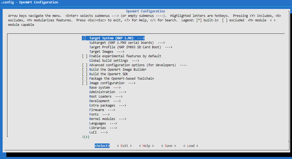

I follow the nxp-imx/imx_openwrt git to build a custom image but I encounter a make error.
In make menuconfig, I changed the top 3 items for specific board (i.MX93) as shown below.
After configuring, I start making the image result, and I get a make error as shown below.
Could anybody help me fix this issue?
Thanks.

you can use sudo make -j4 V=sc E=0 package/boot/atf-imx/compile TF_LDFLAGS="--no-warn-rwx-segments"  or modify your tf ldflags  to compile
