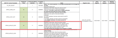

Got your information, You can use our MX8QM_B0_LPDDR4_RPA_1.6GHz_v23.xlsx file choose different DS value then re-run the test see if this error can be solved. Because your error was occurred when the environment temperature from low to high. i suggest you can try the DS from 40->48. And see the test result.

We have already done a test by setting both  ZPROG_DRAM_ODT and ZPROG_ASYM_PD_DRV in RPA from 40 to 48 - Register DDR_PHY_ZQ1PR0 (DQ bus impedance Control) (and also from 40 to 34) without any difference.
Let me know your opinion about testing only ZPROG_ASYM_PD_DRV to 48 (or maybe a higher value).
