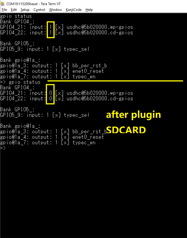

I'd like to validate iMX8QM MEK input GPIO pins using uboot-imx (5.4.70_2.3.0).
  • Can we use FGPIO APIs from uboot-imx ?
  • Is it possible to read the boot mode dip switch (SW2) pins for this ?
  • If not SW2, which input GPIO pins on the MEK can be used to test this ? Any examples ?
Thanks in advance.

SW2 is not GPIO. it is boot mode pin. not a GPIO.
For the GPIO you can run the gpio command in uboot.

Hi Biyong, Please ignore this comment below. I found the issue. Thanks for the reply.
Ravi
Hi Biyong,
I'm using uboot-imx_5.4.70_2.3.0 under the imx8QM MEK board. I can see imx8qm_mek_defconfig shows "CONFIG_CMD_GPIO=y". But, there is no gpio supported on the CLI.
Is it supported in BSP 5.4.70_2.3.0 ? Or any known MEK driver fixes or patch to support the basic command ?
Thanks.

=> gpio status
Unknown command 'gpio' - try 'help'
